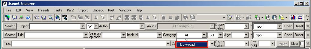

Newznab search bar

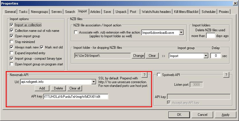

1. Enter nzb website and its associated API key. Multiple websites can be entered each with its own API key.
Note: Since the searches are done on third party servers boolean wildmat patterns are not possible, but wildmat use is possible in the newznab search results view and while using the quick filter.

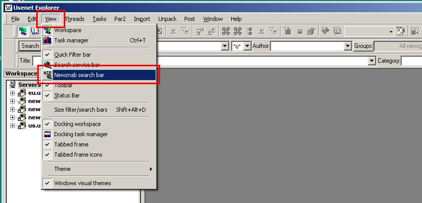

2. Toggle the newznab search bar to make it visible
3. Optionally download the list of categories

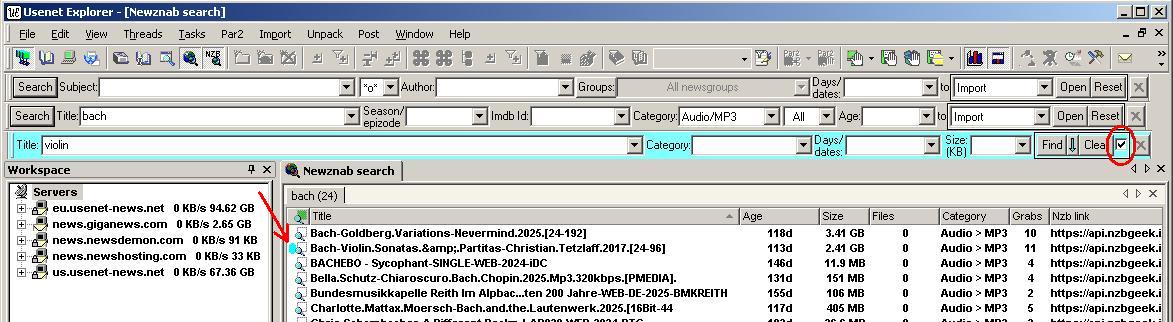

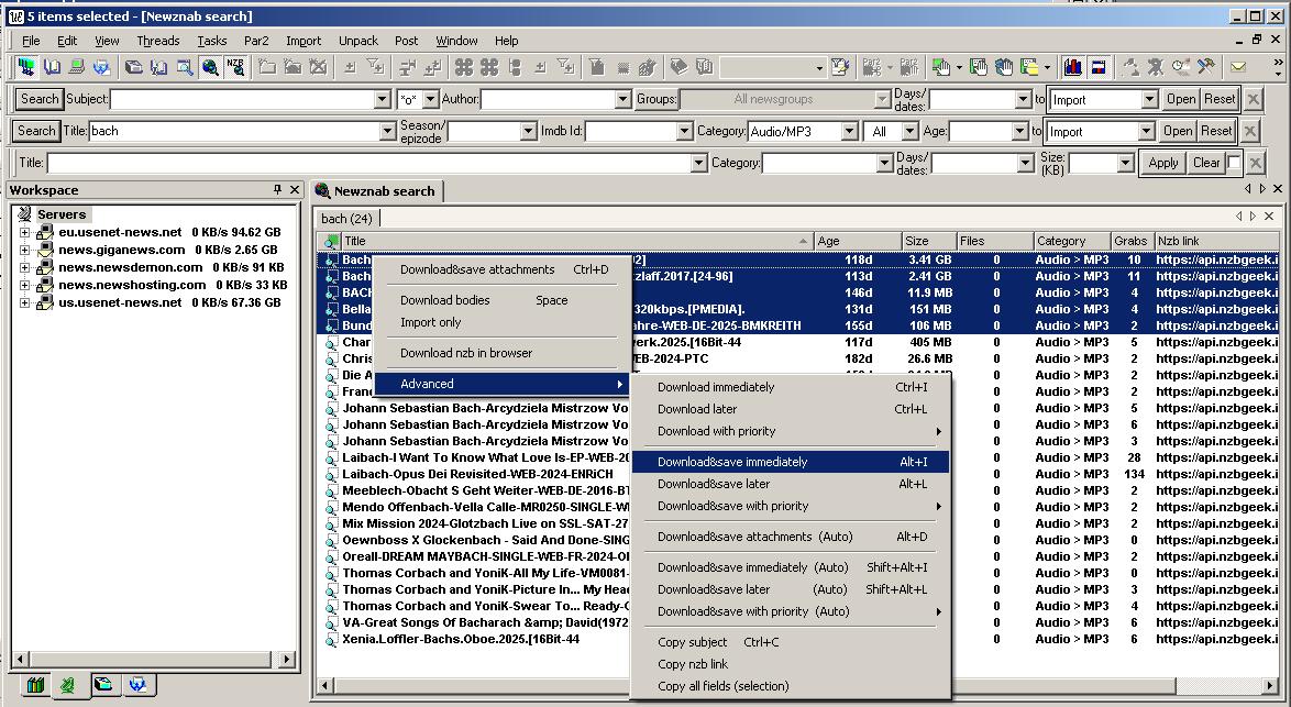

4. Now searches can be performed with context menu options similar to UE search service.

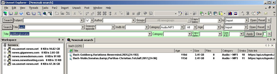

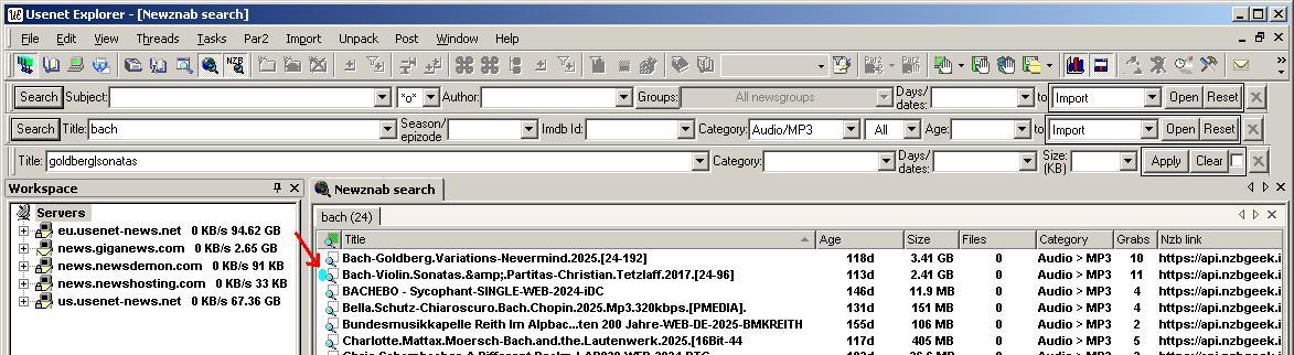

5. Quick filter bar is integrated as well
6. Check the quick filter rightmost check box to switch it to the find mode. The matches will be highlighted as well even in the quick filter apply mode.
