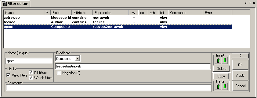

Do you want to see message-id per post or to filter them out?
If you want to see message-id per post doubleclick the set so it will load/expand. For single messages newsgroup view has the "message-id" column, you can see the message-id there (usually there is .par2 or .nfo which are single, partials you can see message-id of parts in show parts mode after marking them for download it is the only way to load them currently, but usually there is a single message it gives you a clear idea about the rest of the set).
To filter them out:
Invoke edit menu->filter editor.
There is a filter there "message-id" in the "predicate" group control.
You can combine it with other conditions like the author using the "composite" filter, e.g. you can create such a filter with author teevee and message-id containing "astraweb". Then you add the filter as kill filter edit menu->properties->kill filters.
If you need something different try to explain what is lacking. If it is something above I could elaborate it further.

The "trick" I didn't see was looking at the single nfo/par file, so that shows message-id then. Good.
I also didn't realize the filter editor had it when the ad-hoc (right term?) bar didn't have it (that bar at the top with the various New/Old, Read/Unread checkboxes). Any chance of getting the message-id in this bar ?
Larry

you may add kill filter like that to edit menu->properties->kill filter to exclude headers matching it from the incoming headers.
just be sure the kill filter is narrow enough (maybe more precise conditions, like full poster name), so it won't filter out valid headers.

I didn't know I could do expressions with filters (teevee&astraweb) !!
thanks again! Larry
