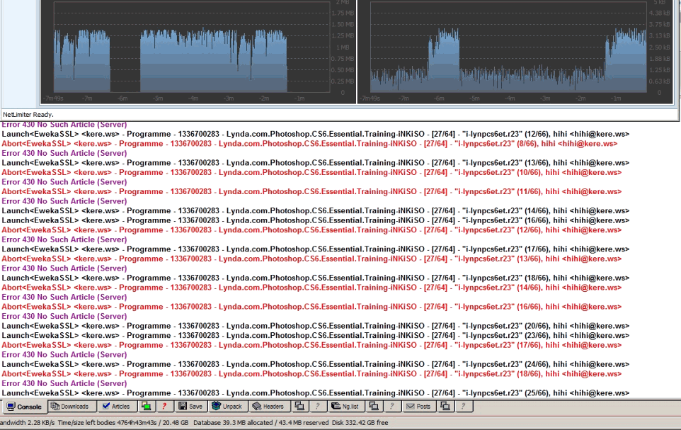

UE task priority was at High or Realtime during all tests.
I'm currently monitoring speed with NetLimiter. That's the graph you see. I'll update this post as test progress.
The article not found errors make the speed drop to almost zero. Sounds obvious because with nothing to download there can't be downloading speed :wink:

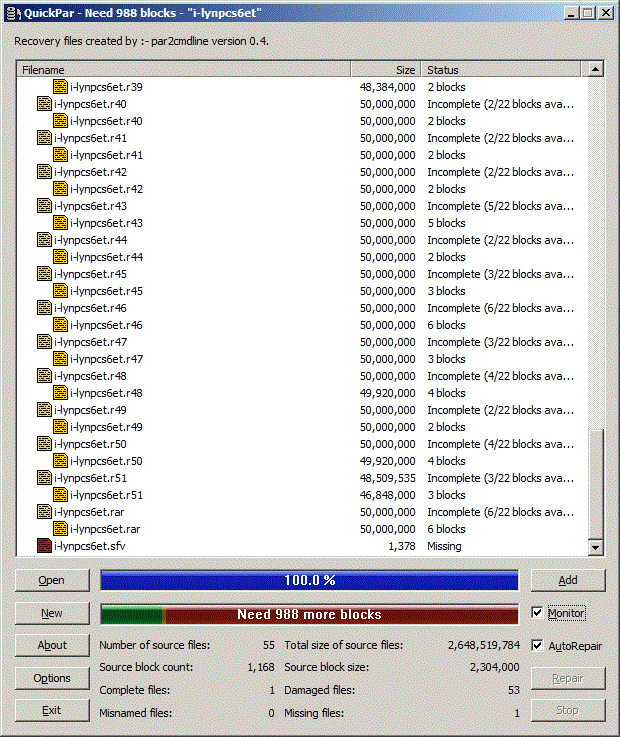

UE reports this set to be 96% complete.
QuickPar shows a far worse completeness (I estimate 20%)
To be continued 8)

If you reduce priority to normal with network threads also normal and the threads of the website download program running you see something different? If it doesn't work well UE normal and threads above normal does work?
Or it is just UE bandwidth counter, but actually it takes average from two intervals so it shouldn't be too jumpy.
Re: Unstable download speed
Posted: Sat May 11, 2013 12:04 pm
by Terry
The above pictures are taken without the website download program running.
I think it's best for testing; otherwise I never can be sure what causes the problems.
So during tests I won't have any download program running besides UE.
I did several downloads after I stopped using that program and UE's download speed is usually very stable and the maximum of my possible download speed.
The tiny spikes in the graph posted are missing articles I think.
The large gaps with almost no download speed is when UE is trying to download *many* previously failed articles.
I've just finished a series of downloads and have 4 sets that are extremely incomplete.
To make very sure the problem isn't with incomplete uploads on my news server I am going to do some test with another Usenet client, other nzb source, and using the UE internal search engine.
Then I'll report back.
Posted: Sat May 11, 2013 12:37 pm
by alex
Missing articles should be slower, the news server does search for message-id, but also UE has clock which may contribute to slowness, I didn't specifically test, I suspect the server would contribute more of delay, as to UE it can be tested by increasing UE clock frequency in the code (need to recompile for that). On the screenshot if 8 tasks and I'm not mistaken the news server contributed >90% of delay.

Posted: Sat May 11, 2013 1:05 pm
by Terry
The i-lynpcs6fpnf set I imported from an .nzb was so extremely damaged QuikPAR didn't even recognize the .par files.
I re-downloaded the files by using your search engine and everything was 100% complete. (no repair needed)
It shows the files are complete on my usenet server. And of course the quality of your search service. But you already knew that :-)
Next test I did was downloading the exact same files using the same .nzb using NewsLeecher. An extremely incomplete result.
Next NewsLeecher test with an .nzb from another source. Again very incomplete.
Final NewsLeecher test with an .nzb fron yet another source. 100% complete.
Used that .nzb with UE and got a 100% complete.
So it seems I got two highly corrupted .nzb files....
It looks like I had extremely bad luck with many corrupt (this and several other file sets) .nzb files.
And using the search service is the easiest solution to fix the problem.
