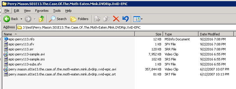

At the end of the download process SABnzbd's download-folder looks like this:
Datenträger in Laufwerk E: ist Volume
Volumeseriennummer: 3677-BE3D
Verzeichnis von E:\Download\SABnzbd\complete\Perry.Mason.S01E13.The.Case.Of.The.Moth-Eaten.Mink.DVDRip.XviD-EPiC.1
02.09.2016 16:11 <DIR> .
02.09.2016 16:11 <DIR> ..
02.09.2016 16:10 385.184 epic-perry113-sample-sample.vol00+1.par2
02.09.2016 16:11 8.142.848 epic-perry113-sample.avi
02.09.2016 16:08 104.141 epic-perry113-sample.srs
02.09.2016 16:08 33 epic-perry113-subs.sfv
02.09.2016 16:10 11.328 epic-perry113.nfo
02.09.2016 16:10 700 epic-perry113.sfv
02.09.2016 16:10 121.995 epic-perry113.srr
02.09.2016 16:10 410.396 epic-perry113.vol00+01.par2
02.09.2016 16:10 1.615.056 epic-perry113.vol03+04.par2
12.06.2007 22:07 366.432.256 perry.mason.s01e13.the.case.of.the.moth-eaten.mink.dvdrip.xvid-epic.avi
12.06.2007 22:13 82.450 perry.mason.s01e13.the.case.of.the.moth-eaten.mink.dvdrip.xvid-epic.srt
11 Datei(en), 377.306.387 Bytes
2 Verzeichnis(se), 311.779.381.248 Bytes frei
AVI & SRT files are present. <<<<<<<<<<<<<<<<<<<<<<<<<<<<<

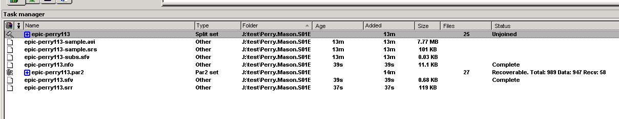

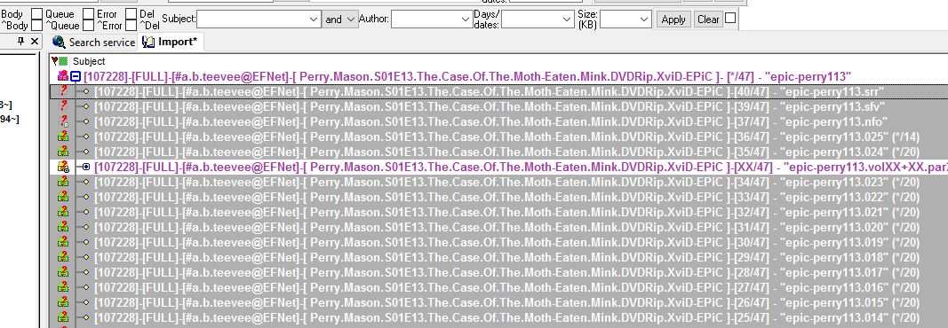

And the UE's Import-pane looks like this. See picture in the attachment.
On the left-side of the Import-pane .. what does the red question-mark on the green-square mean?
Thank you.

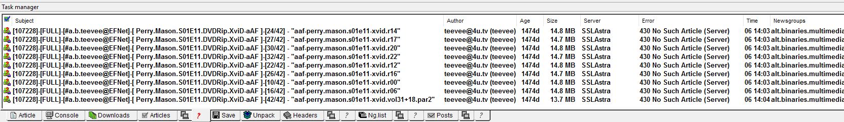

Re: UE cannot download an AVI-file. SABnzbd can. Why?
What is the error message in the tasks menu->task manager? - click on the the red question sign tab, see my last attachment.
I don't see any "error message" ... see below.
Why cannot "my" UE recover ...?
Thank you.
Thank you.
- Task Manager.jpg (126.76 KiB) Viewed 18152 times

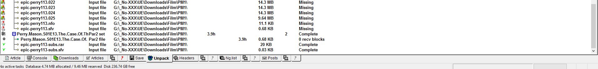

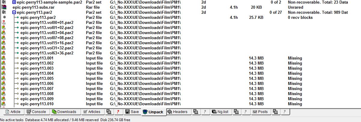

The files are "missing" ... see below.
But .. why?
SABnzbd in my computer has received those files.
I don't understand. Can you? Thnx.
But .. why?
- Task Manager - Unpack.jpg (86.84 KiB) Viewed 18151 times
Task Manager - unpack - missings files
- Task Manager - Unpack2.jpg (143.85 KiB) Viewed 18151 times

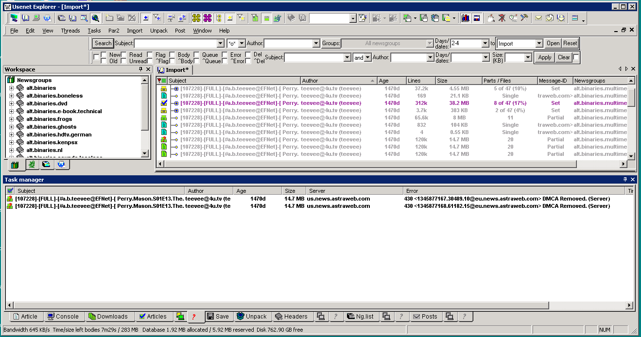

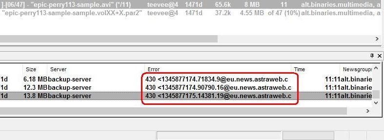

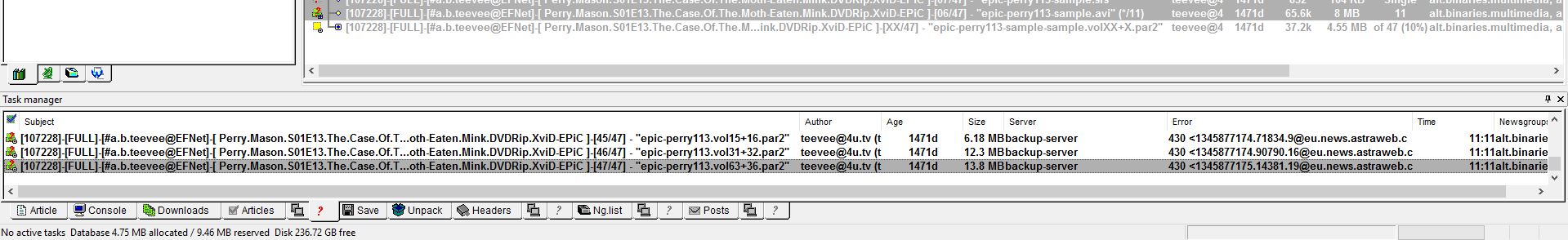

The error is encircled red, if you expand the column you should see it.
Are you using the latest version 4.9.7? Sometimes it is able to get more repair blocks out of corrupted or deficient par2 files.

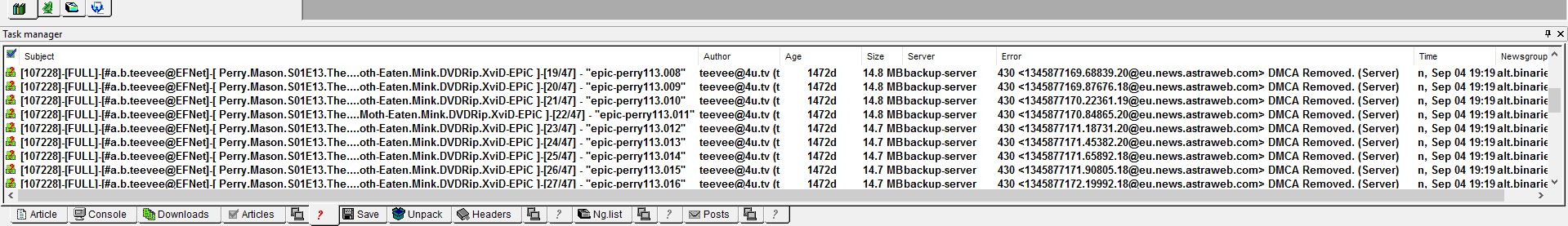

Hello
My UE is v4.9.7 (64 bit).
It's licensed to me.
The error is "DMCA Removed" at Astraweb.... see below.
BTW ... so I "learn" to use UE's TaskManager-panes ... without understanding ...
My question is .. from whom (server) did "my" SABnzbd receive the data? .. and why?
From Easynews?
What can I do to remove this discrepancy between UE and SABnzbd? Thnx.
From Easynews?
- Task Manager.jpg (197.4 KiB) Viewed 18146 times

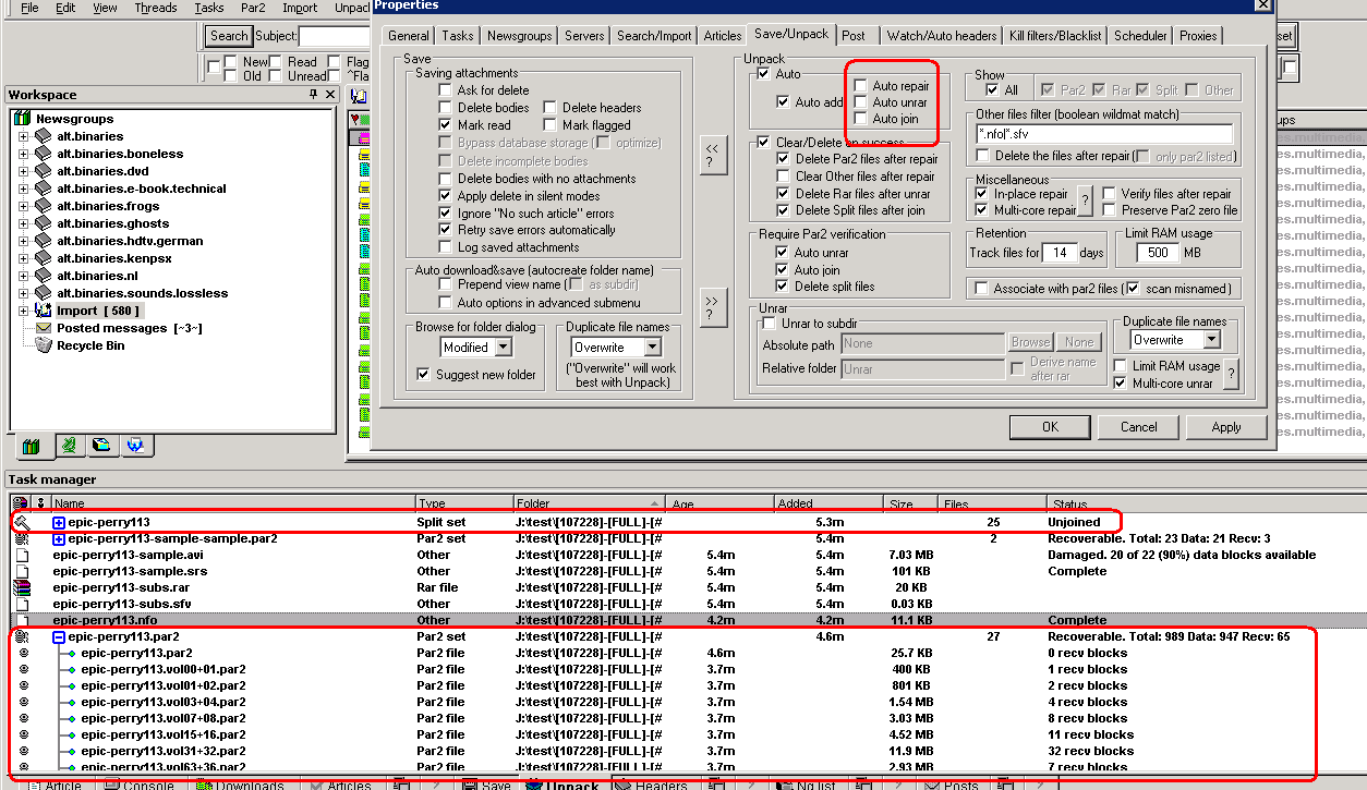

I'm not sure why split files are missing.
Try to uncheck auto unrar, join and repair.
Delete or clear respective files from the unpack pane.
Then download&save again.
Do you see something like that?

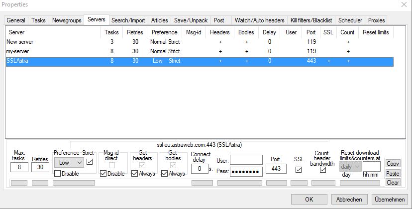

I experimented with SABnzbd with Easynews/Astraweb servers.
I want to see what data came from them.
I saw how the data was coming in.
The data from Easynews is irreparable. I can see that the data is junk/irregular.
The data from Astraweb is "good".
SABnzbd - download with Astranews server:
Download successful. <<<<<<<<<<<<<<<<<<<

I unchecked the 3 autatomatic join/rar/repair ... but it did not changed anything to the download process!
I don't see the data (that will be joined) at all. Why??
What I meant to uncheck those options temporarily, so we can see what is in the unpack pane when the download&save complete.
You can also use a different save directory, just clear old files from the unpack pane before invoking download&save so not to clog the view.
Hello
Eureka! The problem is solved.
No missing data. No question mark. See below.
The AVI & SRT files are there.
I've changed the connection parameters to Astraweb (servername, portnr., SSL etc.)
Can you ask your friend at Astraweb .. what the difference concerning data between normal connection and a special one?
Thank you.
Thank you.
Hello
Although with SSL-Astraweb-server .. UE cannot download an AVI-file (via NZB-file).
Error message: "No Such Article"
The AVI-file is not recoverable. See below.
Please see attachments.
3 other newsreaders (SABnzbd, NewsBin-Pro & Unzbin) have downloaded the AVI-file successfully.
See below.
I've repeated the downloading a few times.
The failure and the successes are not by chance.
Which problem does UE's server-connection have? TimeOut?
Can somebody help me?
Thank you.

- 2.UE - servers-properties.jpg (57.7 KiB) Viewed 18125 times
- 1.UE - task manager - no such article.jpg (162.02 KiB) Viewed 18125 times
Can you make a screenshot with the unpack pane status column fully visible, so we can see how many data blocks, how many recovery blocks etc.
This "Missing" status was strange, it shouldn't be there.
If you see "Missing" and you see the files on the disk try to load them manually, using the Add submenu in the context menu of the unpack pane. If the par2 set becomes recoverable then we would look what caused the files to become "Missing".
