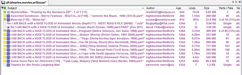

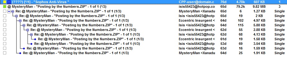

I'm not sure if this might just be me misunderstanding something.
I've attached a screenshot of one group, with "New" checked. I then mark all messages as "Old", using the "Old Man" button in the taskbar, and close the group.
If I immediately do a "Open&get new headers", I don't see anything being pulled from the server, and with a select "New", nothing shows up, which I'm guessing is correct.
However, if I exit the program, reload it, and then select "Open&get new headers", I see headers being pulled from the server, and when I select "New" I see exactly the same list of headers as before.

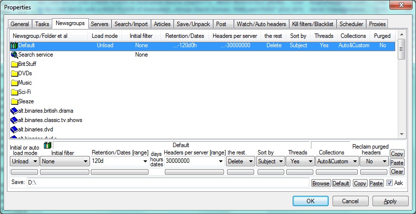

I've also included a shot of the Newsgoups settings, which incidentally shows a retention of 120 days, yet some of the "new" headers show older than that.
This issue is happening on multiple, if not all, the groups I am subscribed to.
Am I Mis-Understanding Old/New Headers.
- NewsGroupProperties.jpg (119.5 KiB) Viewed 12341 times
- NewsGroupMessages.jpg (162.99 KiB) Viewed 12341 times

Retention is automatically applied on loading newsgroup it means headers older than 120 days will be gone when you reload (given your retention setting), the question then is why the older headers are redownloaded.
If you unload the newsgroup (from workspace right click newsgroup -> advanced -> unload) then open&get headers again are the headers still redownloaded?
If they are try to reset headers or header ranges (advanced), then check if the same behaviour persists, maybe the server has changed header ranges.
If headers are not redownloaded would mean settings are not saved somehow (interference?).
What about this partial 64d, @ MisteryMan was it there already? If not clear try to open newsgroup to see what is there after restarting, then invoke "get headers". If no headers means maybe UE is lacking some file permissions.

OK, hopefully I did this in the right order:
Started program and opened group. Checked age of posts, and the oldest was 119 days.
Get new headers, which reloaded the old ones again.
Flagged all headers as old, closed, reopened group. Get new headers, which again, found none.
Unload, followed by Open&get new headers reacquired the same ones again.
Reset header ranges. Mark all old, unload, Open&get new headers again reacquired the headers.

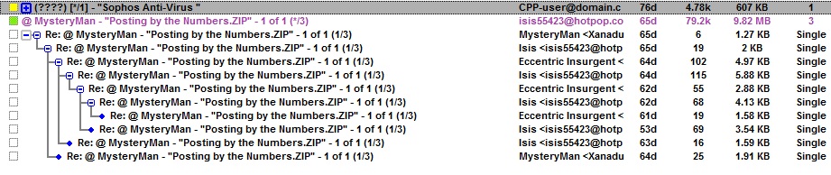

After Unload and Open, yes, that particular entry is with 3 parts. I have included before and after screenshots.
Because you also mentioned file permissions, I checked to see what files are stored with a date/time of when the program is closed. A cursory search found the following:
So, based on that, I'm assuming that there aren't any issues with permissions to save the state of UE when closing.

Re: Am I Mis-Understanding Old/New Headers.
As to the non-logical new/old mix for a recent header with smaller retention, it wasn't reported in the past, something rare related to handling threads of replies in compact binary groups, I fixed it and reuploaded the files, just download it will show v3.3c in the about box, old will remain old.
The main question though why it redownloads headers older than the retention in properties (120 days in your case).
In edit menu->properties->general, newsgroup, rescan headers there is check box "let all incoming headers through", if you uncheck it the headers older than the retention will be ignored, but normally UE should download only new headers unless server misreports header range.

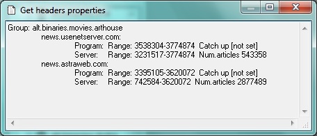

After header download complete what are header range properties, in workspace, the leftmost newsgroups tab, right click newsgroup, advanced, header range properties?

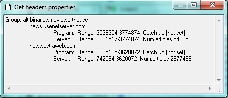

OK Alex, the 3.3c version does indeed fix the issues with the headers that are below the retention date.
I wasn't sure where you wanted me to check the Header Ranges, so I've included both after the Open of the Group, and after the Get New Headers.

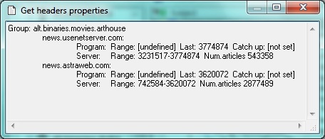

Did you reset header ranges between screenshots "before open newsgroup" and "after open newsgroup"?
"Program Range [undefined]" means it will redownload headers again, but no reason why it would change by itself.

No, I did not reset.
And I just tried an Unload, check Header Range, Open, check Header Range, and see exactly the same sequence. It goes from a value to Undefined on the Open.

Try to redownload UE again, the version you'll see v3.3d.
I minimized permissions UE would need, check was it sufficient not to reset the header range?
If it worked, also check whether you can create and open a new newsgroup, if not you need to adjust permissions so UE can create directories along database path.
Most likely it got access denied somewhere, is UE database a regular directory on a fully accessable path?
