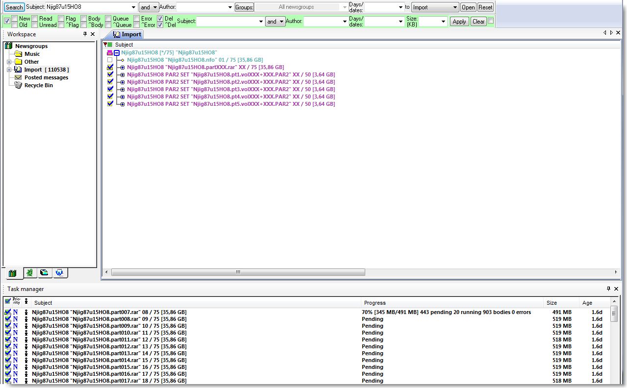

I've just noticed an odd issue in UE v4.1. I've never experienced this issue before so I'm assuming its new to this version.
Basically, I perform a search using the search service, then press CTRL-D to import and download. This works and I briefly see the files in the import folder, but then they disappear from view. However the files are still there and ARE downloading but are only visible if I use the quick folder bar and view deleted headers (even though I have not deleted them).
The attached screenshot shows the files downloading and only visible when I choose to show deleted headers.

As to the wrong header state problem in short it has been now fixed.
