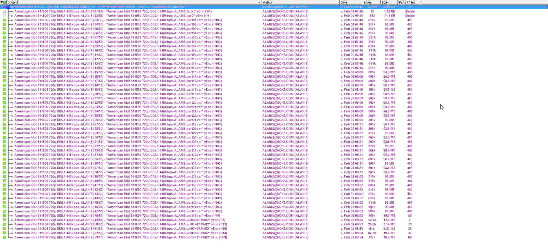

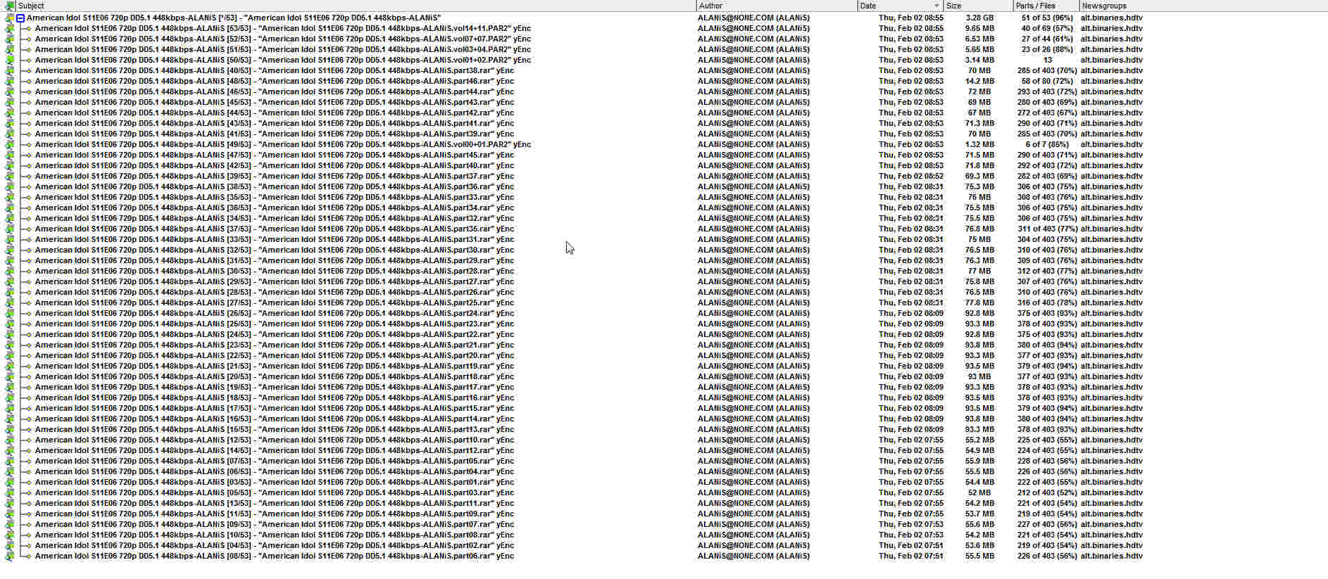

Just wondering, is there currently something wrong with Usenet Explorer's Search Service? Over the past days I noticed a relatively huge amount of incomplete parts, as shown by Usenet Explorer's Search Service. However, when I verified the same posting by using a different NZB index service, the posting was complete. Moreover, I was able to download the complete posting (after importing the NZB file in Usenet Explorer from the NZB index service) without any problems whatsoever, as opposed to when I tried to download the same posting based on Usenet Explorer's Search Service results, in which case there were not enough recovery files available.
Example:
"American Idol S11E06 720p DD5.1 448kbps-ALANiS.ts"
Please find attached two screen dumps plus the actual NZB file I used, which will provide you with further details.
Could you please investigate?
Thanks in advance!

- Different NZB index service - All Complete
- Different NZB index service - All Complete.jpg (136.87 KiB) Viewed 18614 times
- Usenet Explorer's Search Service - Incomplete Parts
- 's Search Service - Incomplete Parts.jpg (183.69 KiB) Viewed 18614 times

Maybe it is because of removing one feed 5 days ago, it appears astraweb has also problem with their headers like they have constantly missing article bodies at least in older posts.
I'll post updates in this thread, there is capability to redownload older headers, I need to change something in the code first to prevent too many users messages caused by header feed insonsistencies. I hope to finish all that within two days.

I don't know, maybe astraweb had temporary problem with headers coming out of sync (gaps in article numbering when fetching headers at too frequent intervals) or it is something more permanent which got exposed when I removed the feed, I'm trying to clarify with them.
hdtv group (your cited posts from that group only?) I've redownloaded last 14 days (I removed failing feed 10 days ago, just added few more days for some case)
I'm also redownloading 14 days for all groups it should be over by tomorrow.
I've also added giganews as additional feed.
If you see something more incomplete let me know.

check, all should be ok now, i finished the update across all groups.
i solved the problem with astraweb, code i wrote earlier to handle low quality feeds clashed with astraweb way which is sometimes not to return headers after returning increased header range.
