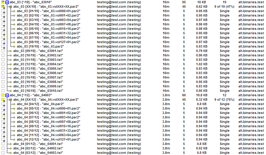

I have noticed that if PAR files are not placed in the end of collection the set and whole collection are marked as incomplete. Is it OK or it's a bug? I am using UE 4.4 (32bit).
Here is an example:

I speculated a bit more and I think that position of pars in collection is not an issue, and it has nothing to do with size of articles. This problem appears when main par file is positioned after par volumes in the collection. As you can see in the "abc_04" collection, par file goes before other par volumes and everything is ok. Some posting programs does not sort files, just adding them as they came from FindFile.

You are right, the issue was not related to single/partial, it was when the zero (non-vol) .par2 file number was more than one higher than the .vol .par2 file numbers, but it worked in the rest of cases (the only requirement UE still has the .vol par2 files numbering should be continuous).
It is not typical to see posts first .vol par2 files then data files then .par2 zero file, usually it is the opposite.
