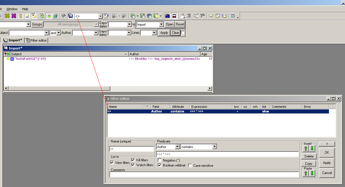

Hi Alex -- There is a spammer who randomizes his Subject, Author name, domain, etc. but the Author name is always surrounded by carets like so:
Subject: [XX/17] - "Xv5QFotXGV.volX+X.par2" - 206,41 MB
Author: <<< Dko68u >>> <bg_oiqinch_dnd_@iemm33z3ht.com>
Date: 09:10
Offset: 24297726 (Valid)
Set
Subject: [XX/17] - "Xv5QFotXGV.partXX.rar" - 206,41 MB
I tried to make an Author/Begins With filter that contains just <<<, but this doesn't seem to work. Can I filter on this pattern somehow?

Sorry for the late reply, I was updating search servers.
It looks like any filter would work, both quick filter or adding as separate filter.
I attached one as an example.
You can use it as kill filter, check for options in edit menu->properties->kill filters.
To open the filter editor edit menu->filter editor or use the toolbar button to the right of the filter combo box.
If something is not clear let me know.
