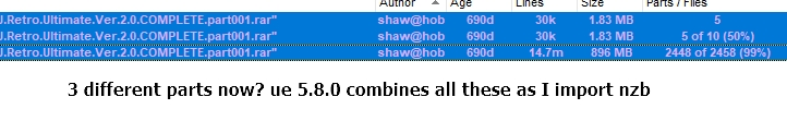

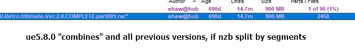

- Added good picture on 5.8.0
- import good on 580.jpg (51.83 KiB) Viewed 40494 times
- why 3 parts now?
- import error.jpg (64.51 KiB) Viewed 40494 times
- nzb.zip
- zip has 3 files.
Full part file, all segments
Split part file, 1-5 segments
Second split part file, 6-10 segments - (14.34 KiB) Downloaded 1927 times

Ah, ok.
The problem here is there are now sometimes obfuscated posts when the total parts in partial is random for example (10/10) (11/10) (12/10) etc.
Then starting with v5.8.1 it would fix the total e.g. if the maximum part is (68/10) it will use 68 instead of 10.
In the older versions it would create a lot of single headers when the part number is larger than the wrong total.
But in your case it would assume the total as the maximum part number in the nzb sample.
I've now changed it so it won't change the total if it is larger than maximum part, with those obfuscated posts it may show incompletes, but it should work just fine.
You can download it from the website I've just replaced the release files without changing the version (it is now "b" when you invoke "about" dialog while pressing Ctrl).
